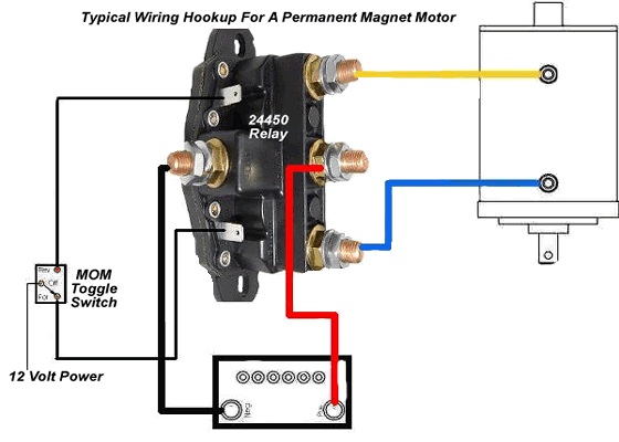

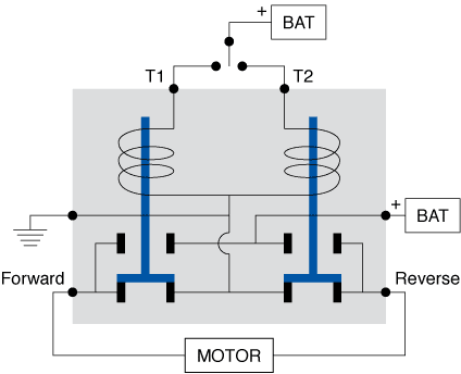

PostPosted: Tue May 08, 2012 12:12 pm    Post subject: Reply with quote
Here are those schematic diagrams mentioned above:
They're for a Cole-Hersee 24450 relay, but the principle is the same with various types of 12v reversing polarity DC contactors.
