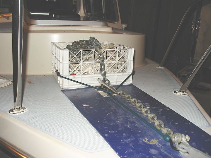

if the chain locker is not in use where are you storing the chain and line? I once used a plastic milk crate to shore a fishing anchor set up on the bow. I strapped the crate to the deck with a bungee and then pilled the chain rode and float in the crate. worked very well.

How do I keep the chain from scratching the deck
Here's one way...
You can make a template out of cardboard and run over to TAP Plastics in Lynnwood.
They'll create a custom deck-guard while you wait.
Custom fit and color-coordinated.
A few dabs of your favorite adhesive will hold it in place.

Thankyou all
These are all very practical suggestions. I like the milk/plastic container idea and the scratch proof covering ideas. A haws pipe seems pretty cool too. I have not seen one. It seems like a haws pipe might bring a lot of moisture into the sleeping area even if there is a spot for the chain/rope storage.
