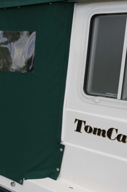

The material which is screwed to the cabin top (and can also be screwed to the cabin sides) is called awning rail extrusion. This is available in both vinyl and aluminum--the vinyl is preferable for boating. This allows a fully water tight connection of the top and canvas. Agree that you want both a zipper on the welt which goes into the awning rail (also called a "bolt rope"--although an actual bolt rope is usually a bit heavier). There needs to be a double flap with velcro over the zipper.
It is far better if the top is free standing, thus the front few inches can be left open for ventilation in hot weather.
Here is a photo of the side using awning rail instead of snaps--and again it will give a more water tight connection:

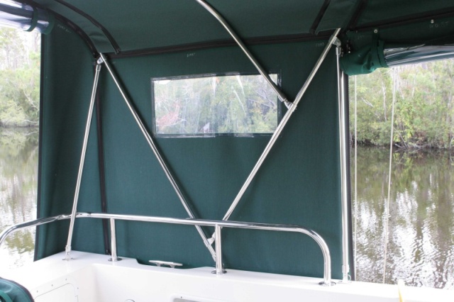

Framework from the inside--and this shows the solid SS support fore and aft for the 1" diameter, thick wall SS pipe, rather than thinner wall tubing.
