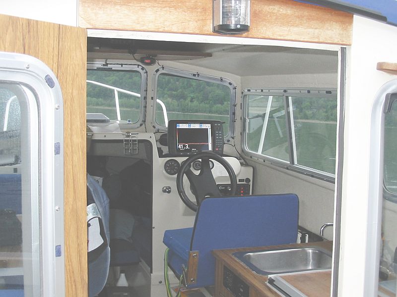

The reason a bracket mount compass is used on my C Dories, is that the dash area is not level, and it is easier to make a wedge of starboard for a bracket mount than a surface mount--this also puts the compass "card" up a little higher, and into the same plane of vision as the chart plotters.
The reason the chart plotters are offset toward the center of the boat, is that I like to put them below the fiberglass piller, which does create a blind spot forward. (again since you have not been aboard a C Dory, you might not know these details).
The reason my chart plotters are under the electronics shelf, and are on the "dash" is that I want them just below my line of sight, not above, where I have to crane my neck, and take my eyes off the water (or put bifocals in the upper parts of my glasses).
My my 18 foot boat, a 5" screen is adequate--for larger boats, I like at least a 6 to 7 " screen. There is more detail visible with the larger screen. The radar is used less frequently and often by the first mate (Admiral) so it is more toward the center, and higher--But in some parts of the world, and doing some types of cruising radar is essential for safety.
If you are going to put fish finder, radar and chart on one screen, then there can be justification for a 10 to 12" screen, but not to obscure lines of sight forward.
