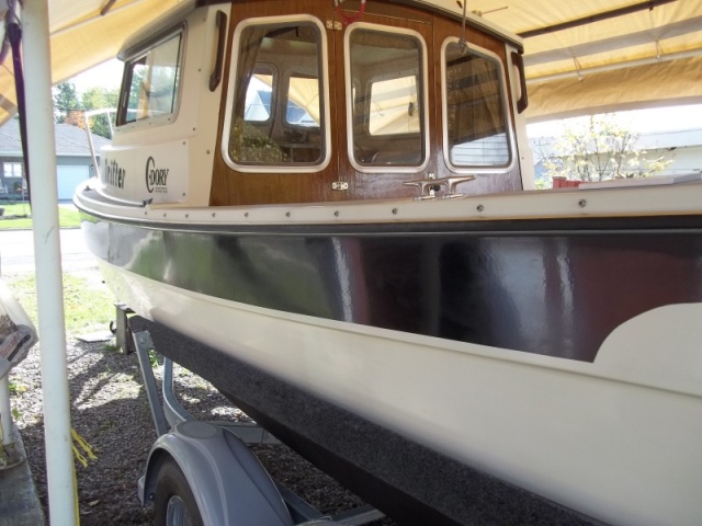

I gave it another go at polishing the Black Trim on my boat.First i rubbed in by hand 3M Marine Rubbing Compound followed by hand buffing Collinites's No.925 Fiberglass Boat Wax. I ended up with a shine but the streaks can be still seen deep in the Gel-Coat. I guess its the best that can be done for the 1985 Gel-Coat. See pictures in album. Tug

I think it looks great!

LOOKS GREAT, WELL DONE.

Ha! That's not too different from the result I got on our 2006! The dark green was hard to get shiny for some reason. I kind of wish our boat had the light gray stripes!
