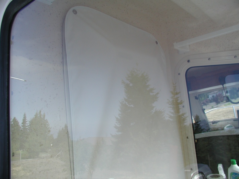

PostPosted: Sat Aug 13, 2011 1:16 am    Post subject: Reply with quote
Here's the shower curtain, as seen through the cockpit window, that the factory installed a few years ago. It completely eliminated the leaks into the cabin. A simple but effective fix.

PostPosted: Sat Aug 13, 2011 2:07 am    Post subject: Reply with quote
I am trying this first as it leaves the user nothing extra to do before or after use. My backup plan involves a small rollup "curtain" affixed to the door bottom shaped like a bell with magnet snaps to hold the shape when rolled out. It would be only about a foot in length and the wings folded inward before rolling it up and velcro would hold it rolled up. I already have the material but thought I would try the most simple fix first.. If a bit of water makes it outside the shower, that will be ok. We just don't need the volume we had at Bellingham with nothing in place and Cindie not being carefull with the spray. I saw your curtain solution Roger and like it but would like to avoid storing it or dealing with snaps or rolling such a large panel up and worrying about drying it somewhere.
