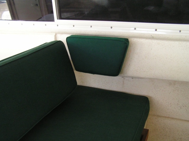

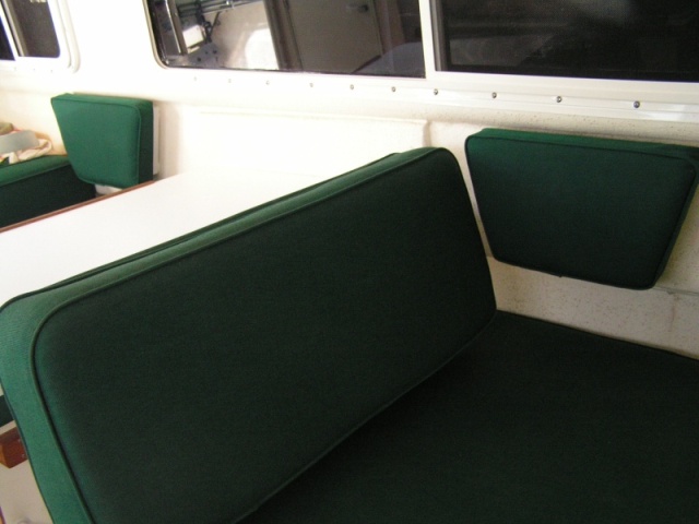

I can finally check off another item off my list. I finished upholstering and installing shoulder pads for the passengers. It was low on my list because it doesn't affect ME! But I felt sorry for my guests having to lean against the hard, fiberglass wall and tuck their shoulder under the window frame. Very comfy now.
I made an identical pad for the rear seat just for symmetry, plus doubles as a nice head/backrest for sitting sideways. They are shaped like that to accommodate the reversable front seat backrest. I used high density foam.

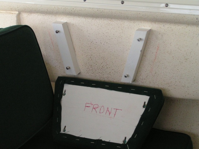

Hey, those look nice!! How did you fasten the cleats to the side of the cabin? My assumption is that they are glued in place somehow.
Steve
Dora~Jean
Joined: 09 Mar 2004
Posts: 1515
City/Region: Simi Valley
Vessel Name: Dora~Jean
Photos: Dora~Jean
PostPosted: Sun Mar 23, 2008 8:01 pm    Post subject: Reply with quote
3M 4200, very tough stuff.
First I drilled the screw holes from the cushion backplate (3/8" plywood) through the 2x2 supports on the bench for good alignment. Then slotted the plywood holes for the large SS screw heads to pass through and slide into place for final assembly. Then painted all pieces with primer and a good exterior paint (2 coats), except for the 2x2 side to be glued.
I cleaned the cabin wall surfaces with alcohol thoroughly. Put 1/8-1/4" beads on the 2x2 supports (bare wood) with them assembled to the cushion backplates (no cushions yet), then glued in place and held tight against the wall with my extension boat hook pressing from other side of cabin. When glue was dry, I removed the backplates leaving the screws in place.
I upholstered the cushions, inserted the foam (cut with an electric knife), then stretched and stapled onto the backplates. Had to loosen the screws about 1/2 turn to allow for the fabric thickness on the backside, then pushed into place and down for a tight fit. About 10-15 hours of designing and measuring, about 8 hours to do the work!
