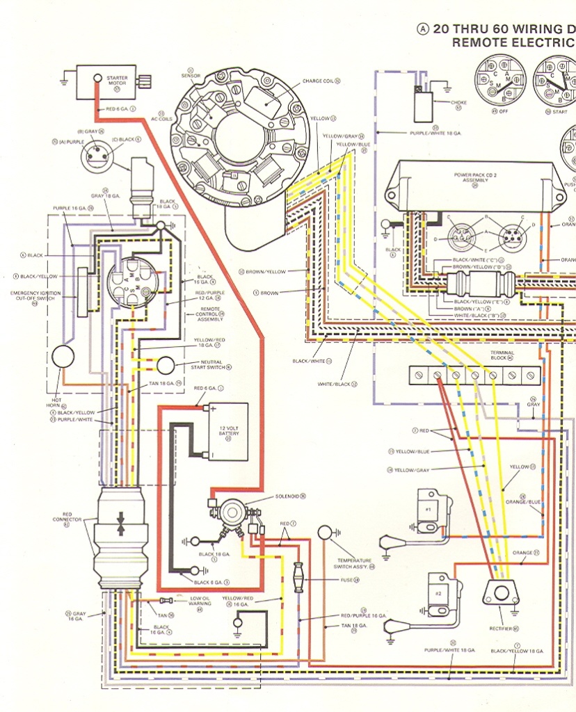

I forgot to say that the 'ignition' switch for a 1988 Johnson 70 hp motor is not at all the same as for an inboard/sterndrive motor. You must get the proper switch for your motor.
Here is wiring diagram which is typical of the J/E 2-strokes. The fuse in question is at the lower center of the diagram and is attached to the starter solenoid.

Thank you all for the great info. It is the original 70hp Johnson. I will look under the motor cover for the fuse. Very likely culprit though the instrument panel still gets power. I do have a very good voltmeter that I was planning to use to troubleshoot. Just needed fuse info to make life a little simpler hopefully. The wiring diag is very appreciated. Thanks again. Will be at boat today or tomorrow and will report back.
