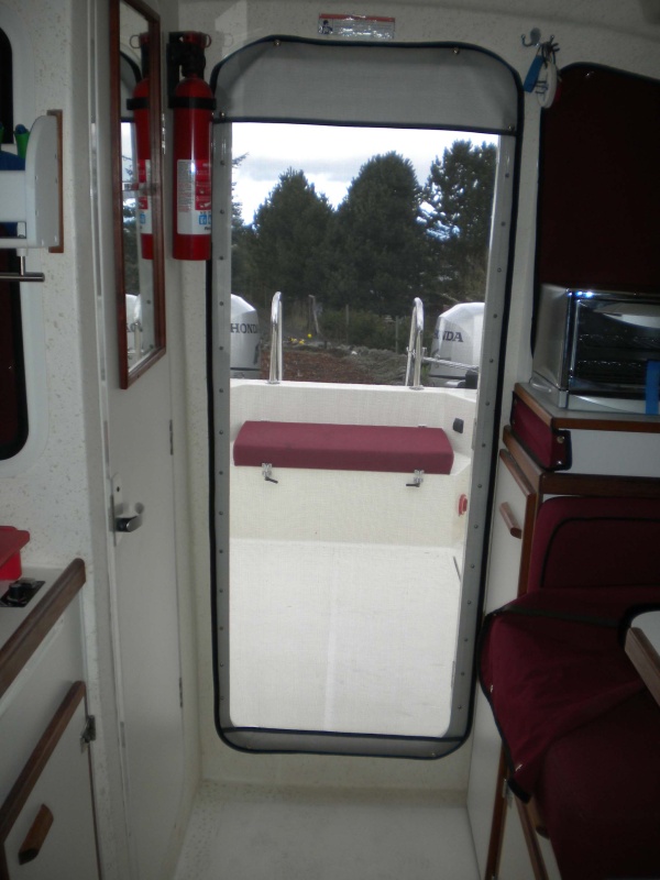

I have seen a screen door made of sunbrella edge that snaps around the door frame with screening just inside of that. It opens with a large "C" shaped zipper attached to the sunbrella. It looked pretty useful. I cannot remember what boat it was on, maybe somebody else can remember it.

We have used the "Endless Breeze" 12 volt fan (and even use them in the big RV many nights). The zipper on the side of the screen works fine. You can also find roll out vertical and roll out horizontal screens made for larger boats--but work fine on the C Dory. The latter will have velcro as a seal on the sides.

The screendoor you described sounds like mine (CC23 Katmai).
As you described, the door snaps around the edge of the door frame, but just inside the edge is a long zipper that goes down one side and along the bottom to make going in and out easier than undoing all the snaps.
Works like a charm.

PostPosted: Mon May 30, 2011 7:06 am    Post subject: Screen Door with full length Zipper Reply with quote
http://www.c-brats.com/modules.php?set_albumName=album1471&id=DSC_0025&op=modload&name=gallery&file=index&include=view_photo.php
........open the above photo off of Sea Angel photo page,
if you look closely, you will notice the great screen door enclosure on Munckin with a center full length zipper....

Thanks for all the replies. I think the idea with the snap on zipper down the middle sounds just about perfect. Much better than my thoughts.
