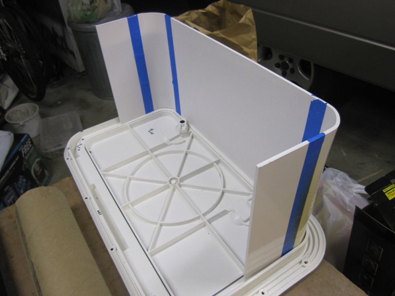

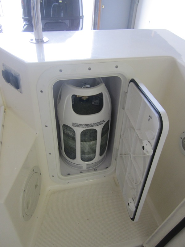

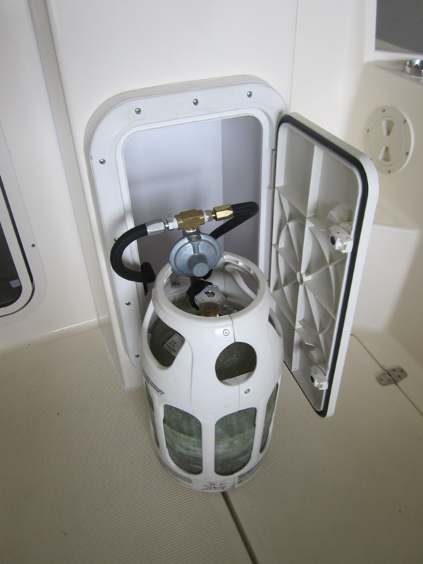

After reading all the information on-line about propane storage, I knew I needed a proper storage locker. I measured carefully and decided that a 10lb composite cylinder would just fit through the existing hatches in the transom and the rear helm box. I asked around to have boxes built but it seemed to take too much time and money so I built them myself. I used ABS sheet and with a strip heater bent the material to match the hatch (no pun intended for you fly fishermen). It was not easy.
The boxes were attached to the hatch frame with 5200 and sealed pop rivets rather than the hollow type. I built two boxes, one for the cylinder in use and one for an extra cylinder.
I had the hoses built at a local hose shop (Williams Oil Filter Service), and installed the fitting on the 2nd end after adjusting the lengths and installing the bulkhead sealing fittings that were purchased from Sure Marine in Seattle. The hose has a cloth braid on the outside and a steel braid in the middle. I would have preferred to have the hoses come out the top but I couldn't figure out how to install the locker in its tight opening with hoses coming out of both the top and the bottom.

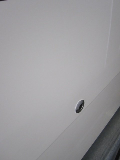

A hole was drilled and tapped in the bottom of each locker and a fitting and hose attached that drains to a through hull just above the waterline near each location.
The front locker (the tank in use) was too deep for the rear helm location so I built 1" spacers to hold the hatch and locker out enough to attach properly.

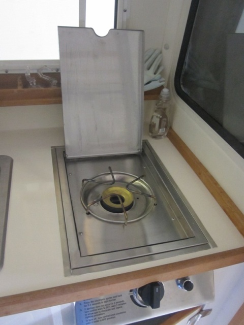

For the stove, I chose a 14,000 btu burner (maybe overkill) but it boils water in a couple minutes and incidentally heats the cabin in about 30 seconds.

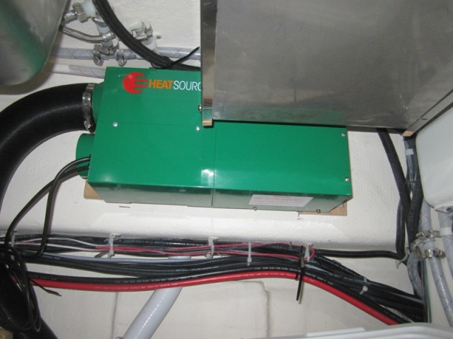

This of course would not do for cabin heat so I chose a Propex 2800 that we like to put in our Vanagons and installed it into the sink cabinet. These heaters have a low current draw and don't use much fuel.
The hot air was run under the helm, through a Y and attached to two outlets under the cabinet, one aimed forward and the other aft.
The heater has an intake and outlet to the exterior so I used a couple of covers to keep rain and spray out.

Also, what is the brand of the stove?

Brian, are those lockers tight enough so that any potential leaks would go to the overboard and not into the bilge? Do you have any kind of alarm that would indicate propane in the bilge?

The lockers are sealed well. If they leaked at all it would be probably be at the hatch and the propane would go into the cockpit. No alarms. I probably would need several but I don't see any more potential for disaster than from having 150 gallons of gasoline aboard.
Not sure of the stove brand, I'll have to look.
