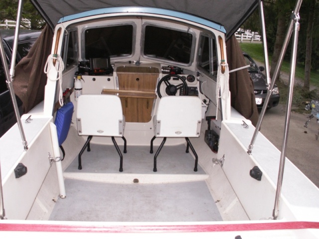

As long as you're considering alternatives, here's what Pat Anderson did on Crabby Lou
