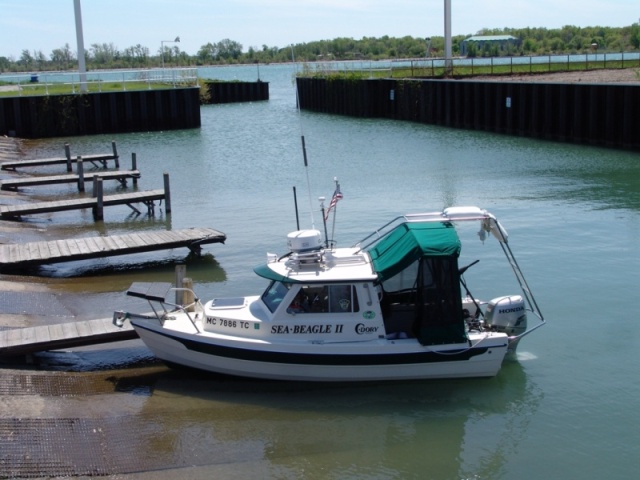

I,ve searched through the site for this and have found lots of info on trim tabs but, can they help a heavy boat ride higher in the water? Recently we had our first passenger, an additional 175 lbs. The result was low riding and impossible to plane. It tells me that our normal cruising capacity is close to the max. Would tabs give any extra lift? Here's a picture of our current configuration. As equipped we can cruise 22 mph upriver and 26 mph downriver with good conditions. 2 passengers, 2 dogs, 3 gas tanks, 2 batteries, tools, coolers, and other supplies. Are there any other 16 Cruisers with them. Also, I already have a permatrim.
