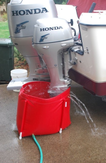

Here's what I use on Constant Craving... In the thread that reported the flushing bags, some of the folks reported using them in the water. It sounds awkward, but I guess it can be done. Here's a link to Quality Marine Products.

Maybe I'm missing something with regard to how that engine flush feed-bag works! I guess you fill it with fresh water, start the engine and then constantly replenish whatever overflows using the hose. With the engine cooling water intake in very close proximity to the cooling water discharge, wouldn't it take a very long time and use a great volume of water to displace the salt water with fresh water?

What I like about the flush bag is that you don't risk ruining the impeller by using a set of muffs. On the Honda 8 in the photo, I burned up the impeller after a grand total of about 15 hours on the engine. I don't know if the water pressure was too much/little, but it started squealing after about 3 minutes of operation. The owners manual recommends never using muffs.
Hence the flush bag. Just make sure that you measure correctly and let Quality Marine know if you have a permatrim plate.

I have attempted to use flushing bags to flush Honda t-40's while the boat is moored in saltwater. Sorry to report that it's a real pain in the neck. It can be done but IMHO is not worth the hassle and possible danger. You have to climb into the motor well and "lasso" the flush bag around the lower unit with the motor up. Then you lower the motor and simultaneously begin filling the bag with fresh water (and a splash of salt away to make things go quicker. Once you lower the motor low enough to safely run it you start it up, flush, then raise the motor, timing the removal of the b ag with the lower unit clearing the saltwater body. It's as complicated as it sounds. If you spill any salt away in the splashwell you're walking on a very slick surface. I'll keep the bag for trailer flushing but keep looking for a credible fitting for an easier flush. Mike.
