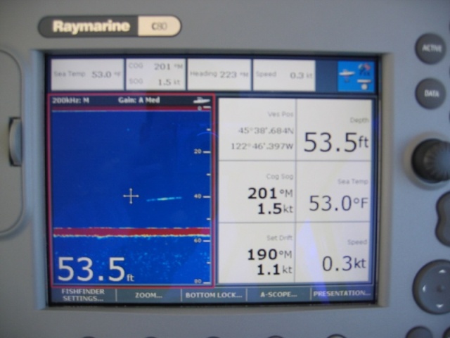

I have the Raymarine c-80 and feel that that size is perfect for the 22. I don't think I would like a larger screen there. The c-80 can have many customized screens so if I want to read the numbers from the cockpit I put up a screen like this:
Maybe Furuno can do similar stuff?
