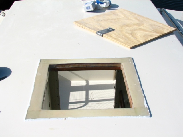

The radar mounts which I build use 4" PVC pipe, and PVC water closet (toilet) flanges top and bottom. The top is boated to a piece of Starboard, and the bottom is thru bolted thru the cabin top. The outer part of the flange may be slightly more than 6"--it is put in with the bolts on the bias (at 45 degrees to fore and aft). Thus the part which is bolted is not far apart--about 6". The air conditioner, was a 14" square cut out, with a 2" flange, built around the outside.
