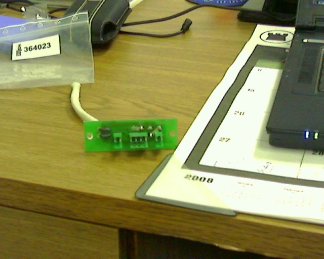

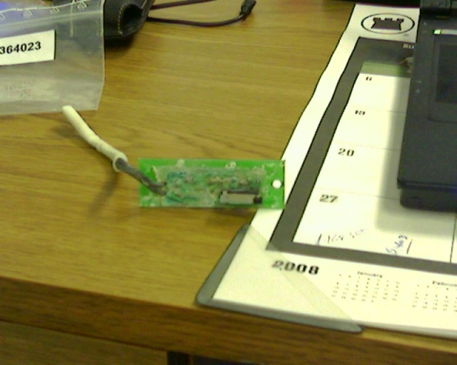

This year it started to act up again and was working on and off all summer. Some times it would run, sometimes not. At first it would only start if the lid was up. Then it would only start if the main engine was running. Then it would try to light by never get pass the start up stage. It would pump fuel then shout down and never light. Then we got to the red light flashing as soon as you hit start. Again the only two lines they know at Scan marine is " voltage drop" "and bring it in" Well after doing what little I can I took it in. 120 mile later and $300 lighter I have it back. I have not put it in yet. What I really hate about this is that there is not trouble shooting guide. It seems the problem this time was a bad switch on the lid. Look at photos of the removed switch. Looks like a little water got in there, damm crab. The bad side faces up into the unit under the glass and you can not see it from the outside. You would easlly miss looking at this if you did not know about it.
When you hit start the computer ask the stove what postion the lid is in, is the glow plug grounded?, do we have X amount of voltage? etc... So if the computer gets a No answer it shouts down. Well it it can do that then it can tell me what broke so I can look at it or replace it, but noooo the damm finns what you and I to go to the local dealer to get our wallet lightened. I want a trouble shouting guide for this thing but they say it does not exist. I know some one has one some where at the dealer. So if you are not getting your wallas to light off this is one more thing to check before you send it off to get fixed. The part was only $80 the rest was labor. I takes $220 dollar to remove two screws and unhook this part. Thats about 54cents a second for a two mintue job or $1944 a hour. Ok I feel better for now
