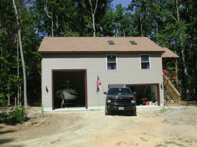

Hey Rob, here's what you need!
The door on the "tall" garage is 10' wide x 12' high. My old CD22, with a single axle trailer fit just fine with some room left over. Not sure if the new TC255 will go in there, haven't had the need to try (yet).
