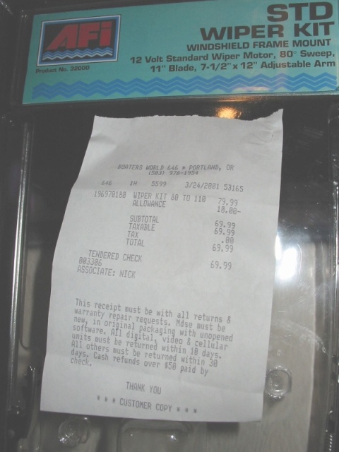

When I went electric I opted for the AFI Standard kit. I never got the self-park to work satisfactorily so I simply park it with the on/off switch. I picked up a wiper-delay but never installed it. This electric required NO HOLES and was a straight swap out. I use the original arm so from the outside there is no change in appearance. More here AFI Electric Wiper Upgrade

Thank you as well for your reply. It seems that the AFI brand of motor is very common among fellow brats. That would be the one which the factory installs so a person can't go wrong there. I will have to see if I can get that brand here in Canada. If not I may have to order one to be shipped here.
I believe the factory goes with a different model in a rectangular gray housing. I can't remember exactly why I didn't select that one since it would've been my first choice. I suspect that the larger size was a complication for my installation or it required drilling holes.
