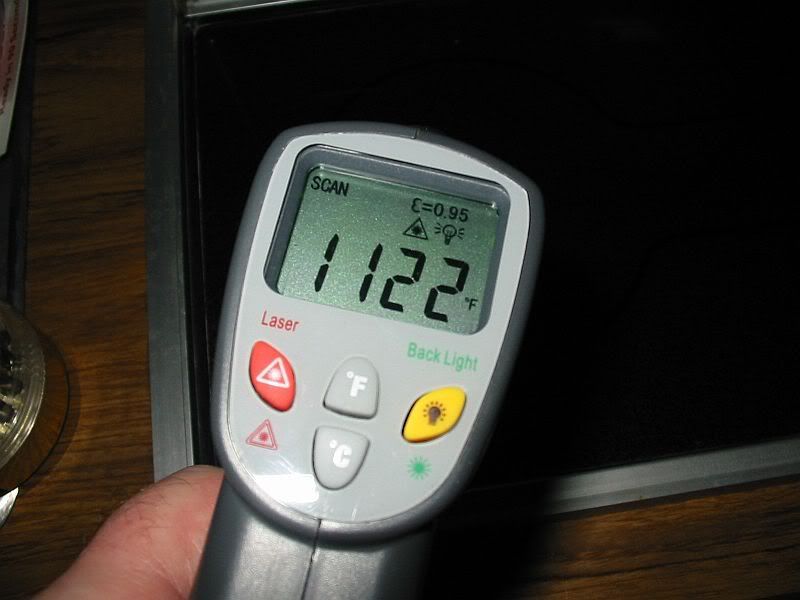

After a cool-down I restarted her and now she runs like a champ. I track her performance with an infrared digital thermometer and until today 1117 degrees was my benchmark. After the alcohol treatment I registered my highest reading ever, 1122 degrees.

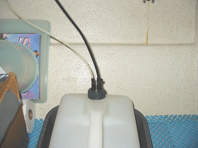

Sounds like a good technique, but I am confused by the reference to a return tube. My Wallas just has a fuel supply tube, and a vent tube coming off the plastic fuel jug. Both are clear plastic.
Does your's have a return line, or some kind of combustion chamber overflow?

Yes, my Wallas has a return line(black) that terminates inside a chamber within the "cap". I forgot that they changed the design on the newer ones.
