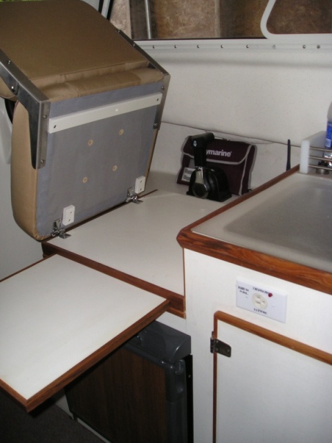

Here is what I have done. The seat is held on with slide apart hinges. I just take it off and I have more counter space. Under the seat I have a pull out "cutting board" for even more counter space.

Nice solution, David. Not to hijack this thread, but could you tell us about the inverter you are using and the wall socket under the sink? How it's wired? Capacity?

Jim, the inverter is a Xantrex 1000W unit that is mounted overhead in the starboard compartment aft of the cockpit over the house batteries. This gave me the shortest 12V wiring I could get. I just have to pop open the hatch door and flip the switch. The receptical in the cabin is a dedicated plug-in straight to the inverter. I added a small red indicator light so I don't forget I turned it on. An inverter does use a small amount of amperage just being on even though nothing is plugged in. I am looking for one of those little pre-engraved plastic labels that says "Inverter" instead of the felt tip sign I have now.
1000 watts will run a small 4 cup coffee maker, coffee grinder, etc. You know, all the important stuff.

Thanks, David; I appreciate the information and will look into doing something similar when we get back home.
