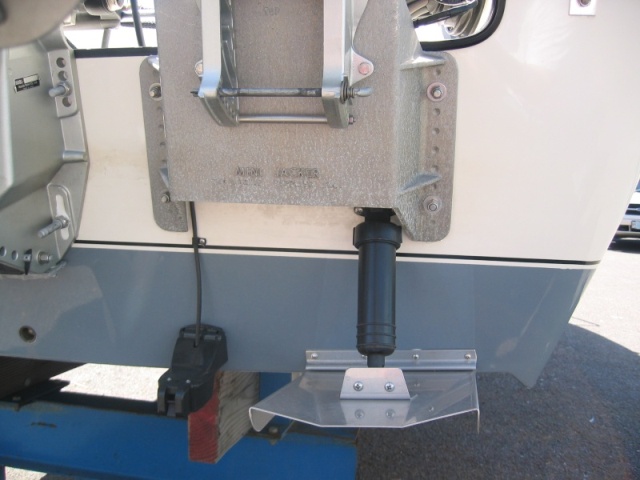

Trim tabs really help smooth the ride out by lowering the bow. Most people have bennett trim tabs. I honestly don't know the model number. You could always call a c-dory dealer and ask them what kind they install but chances are another brat will chime in with the answer. Here's a picture of mine.

Our Bennett trim tabs are the M120's. I think they're the same as Spencer's pictured above. As Tyboo says, it's almost as if they're designed for C-Dory's. Here's a pic of ours mounted on the boat. The bracket is called a Mini-Jacker. I know the factory had some available during the factory party in January. You might want to call them.
