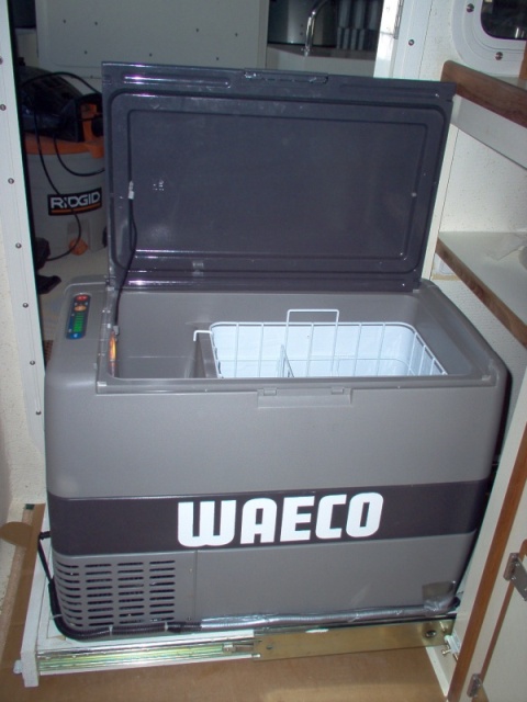

Thanks for all the great information. Based on the sizes available I think I'm going with the Waeco CDF-40DC. I think the under helm cabinet in the 22 is probably a little smaller than 25's and Cats. I was first considering a dual voltage model but after giving it some thought I don't see any advantage since if I'm plugged into shore power or generator power the load should be picked up through the battery charger. The straight 12 volt model's exterior deminsions are slightly smaller than the dual voltage model in that the handles don't stick out on the straight 12 volt model. It appears from the pictures that the handles aren't removable on the dual voltage model.

Thanks to everyone for the information. I finally found a Waeco website with a decent help line. The handles on their coolers are removeable which will allow me to use the dual voltage CF-40 model. My plan is to mount the unit permenantly in my boat under the helm seat and use it as a freezer loaded with bags of water/ice that can be transferred to a small cooler when I go out. I'll leave the unit plugged into shore power in the lift. Ice is a real pain for me as my dock is 1,000 feet from my house. The closest Marinas for ice are 15 miles away. My house batteries are two group 24's paralleled and I'm hoping these will be adequate. I'm guessing like most freezers it can keep thing frozen for several hours with power off? When I go on longer trips I have medications that must be keep refrigerated so with the freezer it will allow me to take longer trips. One thing I have learned through my research is according to the manufacturers air space around the Waeco unit isn't as critical as it is around the Engels.

I completed the install of my Waeco today. In order for it to fit in the 22 I had to make the under helm cabinet 3" deeper. I used Brazilian Cherry to build it out and I think it came out pretty good. I got my hardware for the sliding shelf at Lowes and mounted it to red oak tabbed to the hull with epoxy and cloth plus bolted it where I could. I think I'll be happy with it and will extend my cruising range and trips ashore. Pictures are in my photo album in the modifications folder. Thanks for the information and recommendations.
