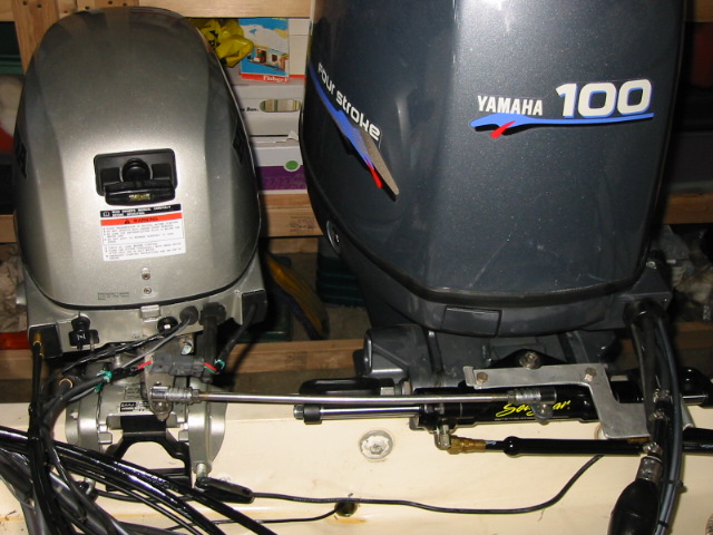

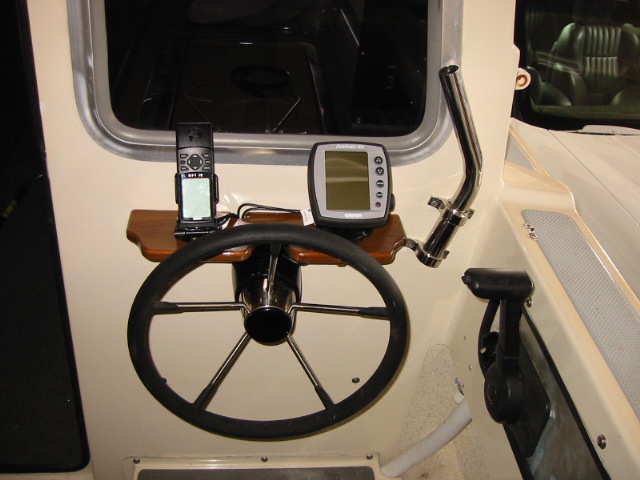

On Snoopy-C I have a tie rod to the main motor for steering plus the trollmaster to control the speed and direction on the kicker. I do this from the cabin. However, I installed hydraulic steering, and put a second helm on the cabin bulkhead, plus remote trolling motor controls on the side of the gunnel. That way I have full control of the trolling motor from the cockpit steering helm. I also placed a second fishfinder, and second gps to monitor fish, depth, and track from the cockpit helm. It works great, but I admit turned into a little spendy project ($1200). I just wanted to do it. I had toyed with the idea of stick steering, but the cable steering was sort of a no feedback system (it was hard to turn the main motor without using the cable helm from inside the cabin. The stick steering would have been hard to use with that system.
