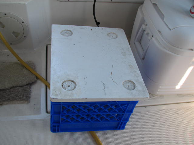

I was asked to post some photos of the Honda EU 2000i with the 6 gallon remote fuel tank, on the swim step of the Tom Cat 255 by some members of the Power Cat list.
The last photo shows the 3/4" thick board, with the 1/4" deep circules cut for the feet of the Generator. The reverse side of this board has four "cleats" which are 3/4" thick and 2" x 2"--the entire boat is epoxy coated.
Both the tank and generator are held in place with bungee cords when running. The tank is secured to the railings , the generator crate is jamed between the cables of the engine and the transom. The exhaust is always directed outboard.
