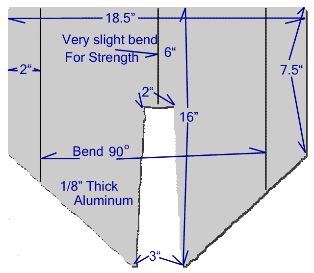

Does anyone have a pattern for a permatrim to fit a Honda 90. I know some people have made their own (Oldgrowth). I have not been able to find it with the search engine.

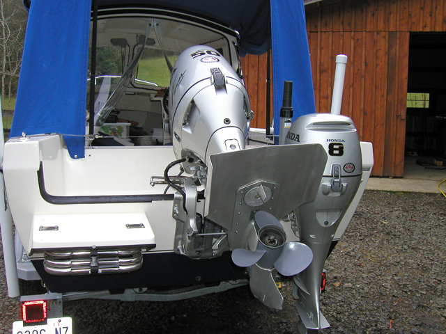

PostPosted: Mon Apr 14, 2008 1:42 pm    Post subject: Reply with quote
Here you go:
It's in Oldgrowth's Sea Voyager Album.
Remember, this was made for a 50 hp, although somewhat oversized.

Joe, thanks for posting the pattern.
Chris, "They're not that terribly expensive ", Thats relative to your tax bracket. Why buy something you can make yourself? It might turn out a total flop, but I'm going to give it a try.
Terry
