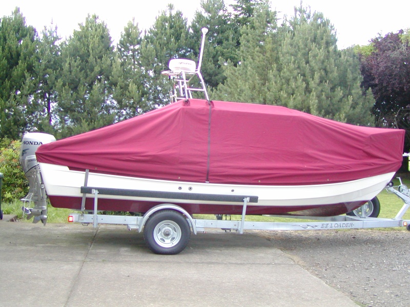

Robert,
Here's a shot of my boat with the cover on. I can not imagine putting this on while the boat is in the water, unless there are finger piers on each side of the boat... It's a handful just getting it on while the boat is on the trailer....

Steve... what brand is the cover you show in the pix and where did you purchase?

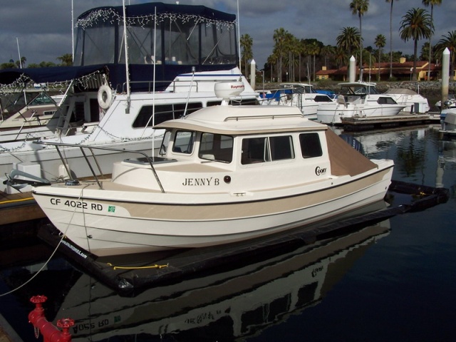

I use the factory option mooring cover which is a partial cover and is a snap to use in the water (no pun intended). Because the So Cal sun eats up the thread used to sew it together, I only use it when there's a possibility of rain. Not often around here....
Here's a partial photo.

Sneaks, have the cover sewn with Tenara Thread by Gore(Gortex)--this is the standard for Sunbrella. It is quite UV resistant. I have usually just used dacron thread for covers I have made, and get 5 to 6 years before re-stitching is necessary in daily use in S. Calif. There are several other UV resistant threads, but they do cost more $$--well worth it.
The cockpit cover is a good addition.
