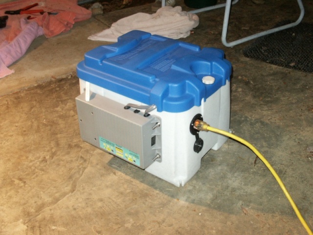

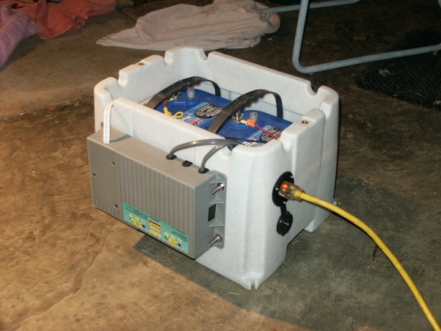

I was digging through some old pics, and found the images below I took of my old 19 Angler setup. This worked really well for me - it's a Blue Sea battery box, with just enough room for two Optimas. I bolted a waterproof charger to the side, then wired it to a power outlet - also installed in the side of the box.
Made for a very compact setup, and to charge the batteries, I'd simply pull an extension cord into the cockpit. It didn't extend into the cockpit, and there was enough room to the side once installed to get at the drain plug.
