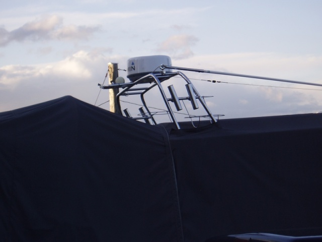

This is what the dome looked like from the ground. Couldn't really see anything out of the ordinary.

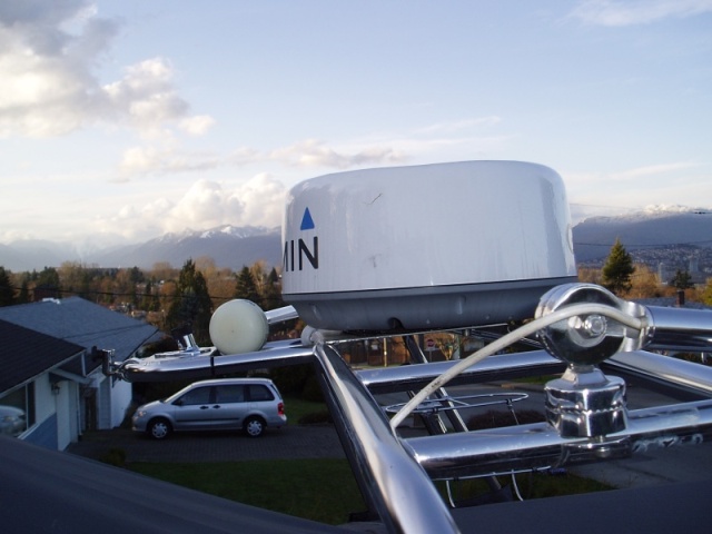

This is what it looked like at eye level.

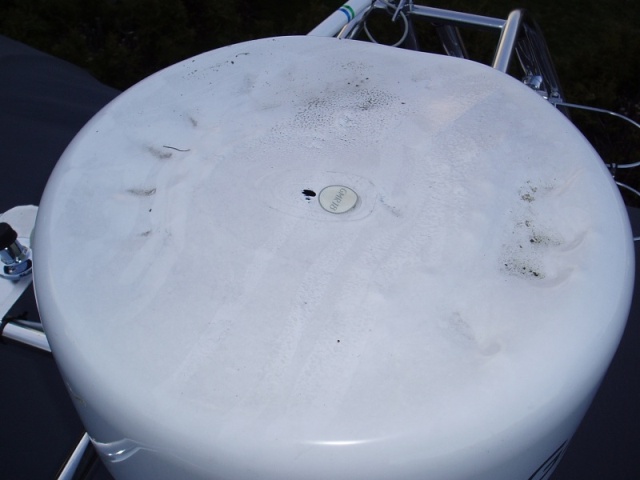

And this is what it looked like when I got up high enough to see the top. The dome is melted and warped and there is a hole melted through the plastic about the middle of the dome.
What happened is, just before Christmas I had the boat in at the dealer for some warranty work. Because it was fairly cold they had the boat stored inside the shop for a few days. Well no one noticed that the overhead radiant heating was close to the radar and of course was on because of the cold temps.
The dealer Galleon Marine, was excellent about it, when I told them what happened. They just replaced the radar, no questions. I was impressed how quickly they did it. Same day that I took the old melted unit in, they replaced it with a brand new one. Cudo's to them. Beer
