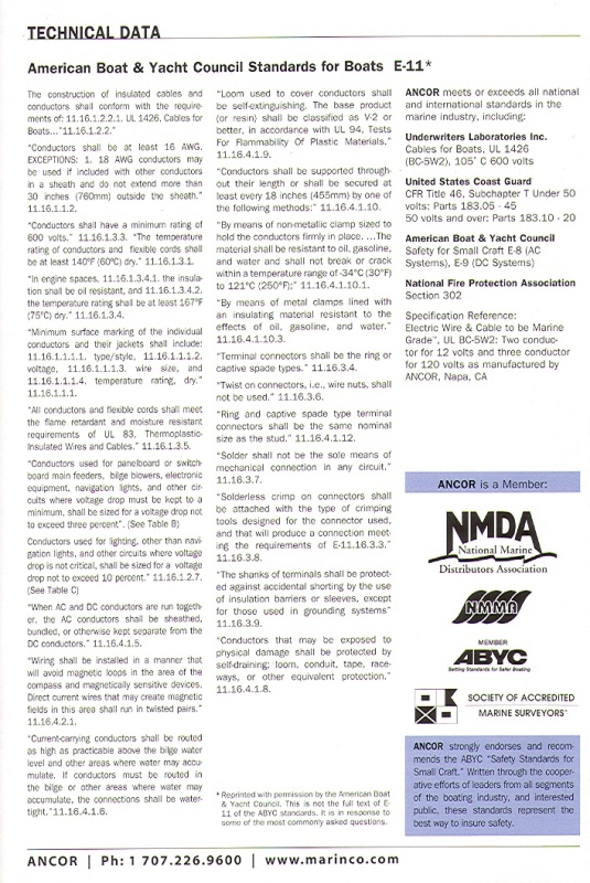

Brats,
I have copied selected pages from a wiring catalog and posted them in my photo album. There was no copywrite indicated for the catalog. You can figure out whose catalog it was.
If the photo is too small to read, after opening the photo from the thumbnail, place the cursor on the photo and click and a larger photo will open. You can then save that photo to your 'pictures' on your computer. When viewing the picture, you can enlarge it or print it.
I am posting this as a courtesy, use at your own risk. If you are unsure how to select or install wire, ask someone who knows.
