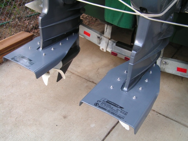

Well I did it, ordered the Permatrims a week ago (Monday), on my doorstep Friday. I bit the bullet because I determined that my stern needed more lift than the trim tabs could do alone -- efficiently. Background: My boat runs best with the motors all the way down (negative trim) and with some trim tabs at 15-18 knots, my normal speed. If I trimmed the motors to neutral (i.e., AV plates parallel to the water flow), the boat was slower at the same throttle setting even after adjusting the trim tabs for maximum speed.
More pictures in my album here.
I was pleasantly surprised on the quality workmanship and finish, right down to the near perfect color match to my Yamaha 80's. All the hardware (SS) was packaged well and the proper count. The instuctions are a bit weak, mainly a crude drawing, but adequate. I conversed a fair amount with the vendor by email on installation, performance expectations, and other technical details, he seemed quite knowledgeable -- another pleasant surprise. And most emails were on SUNDAY'S!
Took me about 2 hrs to measure, re-measure, position, re-position, mark, re-mark the holes on the first engine. Then 20+ minutes to drill that first HOLE, then about 20 minutes to drill 9 more -- a tip, drill the two end 1/8" pilot holes first, then 1/4" and insert bolts, that will mitigate any possible movement of the Permatrim while drilling the remaining pilot holes. An important note not mentioned in the instructions: After you remove the prop, cover the spindle and area with a plastic bag to keep the shavings out. I carefully cleaned the surfaces and applied a good bead of 3M 4200 (they recommend 5200, too permanent for my tastes), inserted the 1/4" SS bolts, washers and nylock nuts, torqued down to snug only, got to be careful with SS, it is fairly soft, the vendor pre-warned me.
Some downsides I came up with re this add-on: 1) More difficult to fish around, 2) More difficult to clear the prop of seaweed or other debris, 3) Will probably search out your knee when you least expect it while walking around your boat.
Upside, should improve gas mileage (efficiency), especially for twins. The true amount of difference will take some time to determine based on sea conditions and boat loading over the next several months. I plan to start with engines at neutral attitude, then inch them down when at speed (15-18 kts) until maximum speed vs rpm, then memorize that position. Will use the trim tabs only to balance the boat laterally if needed.
Stay tuned for data updates, I go to Catalina this coming weekend, but boat will be heavier than usual with scuba gear on board. Looking forward to try'm out!

I installed the Permatrim on my Yamaha 50 to power my 16'er. Couldn't imagine running with out it. There are no trim tabs on a 16. For the same reasons you mention I want to increase the lift on my 19'er which has trim tabs and is powered by a Honda 90.
I built a gig out of cardboard to aline the holes and to get the correct position on the cavitation plate for the Permatrim on the Yamaha. Came out perfect ( no other way Very Happy ). I plan to do the installation the same way on the Honda. Wish me luck Wink. I will watch to see how you like the performance on the twin 80's and the 25'er. I know my 16 didn't like bow down at higher MPH. Only slower in rougher water.

One of the things that I did when I put the Permatrim on Constant Craving was to cap each of the stainless bolts with an acorn nut. Sooner or later, I expect that I will try to use the plate as a swim ladder and slice myself up, hence the acorn nuts.
By the way, your install looks great!

Thanks for the good words, I feel great now that it's over. I thought about acorns nuts too, might do that, but will try cutting off the bolts first then light grinding to smooth out, if doesn't work, the bolts should be about the right length for acorns then.
One other downside I forgot to mention, the Permatrims are almost 1/4" thick. This causes some interference with a normal socket and low profile 3/8" breaker bar to get to a couple of the lower end bolts. Might have to sacrifice and grind down a socket a bit just for that purpose.

You will like the PTs. Will really get the bow down, will allow you to stay on plane a couple of kph slower, will give you some lateral trim without the trim tabs (trim tabs are better for this). I wouldn't go back.

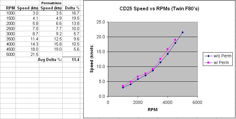

Here is the data with and without Permatrims. As I mentioned before, I'm skeptical that there's so much difference (11.0% average increase in speed) even at low speeds. Interesting to note the reduced delta near or just beyond hull speed. I calculated that the boat was about 175 lbs lighter on the "Permatrim" run. I'll try to get more data on future trips.

Interesting--suggests that the "lift" has improved effeciency??--but hard to know until you have fuel consumption.
Was 4500 the max RPM you could achieve with the Permatrims?

No, 4500 wasn't the max RPM, just the fact that I was about to see the Cabrillo launch ramp breakwater up close and personal inside San Pedro harbor! It was raining pretty hard by then too, visibility issues. I'll get a chance to wind her up on one of my trips. Beginning to eye 4-blade props now, to bring the WOT down within range where it should be.
