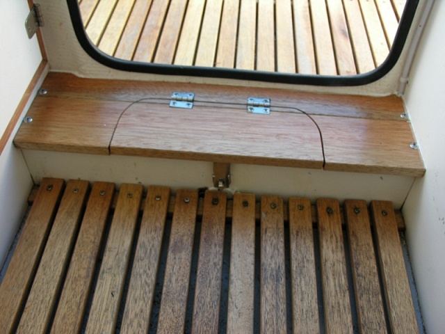

Teak is nice. Take a look at our teak projects in our album. You can make it like our cockpit, but a little tighter as you won't have to think about so much dirt, etc. As is, it's very nice on bare feet. We had some just like it in our sailboat cockpit for yrs.

I did the cockpit and cabin floors on a CD22 and you can find pictures in the Kingfisher album.
Comes out much cheaper if you use standard mahogany strips from the lumber yard and apply many coats of poly.
All joints were screwed (stainless) and epoxied
Merv
PostPosted: Mon Mar 10, 2008 11:51 am    Post subject: Reply with quote
What a sneaky way to get someone to go through your album looking for these pix. Very nice!!
