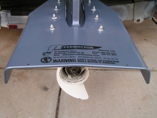

What ever engine I get will have a Permatrim, so a trolling-plate wouldn’t be an option.

You might be able to find a spring-loaded plate that closes downward to give you a slow troll, some mfr used to make them. The Permatrim has two holes at the rear edge, I suspect that might be one of the reasons for them.
