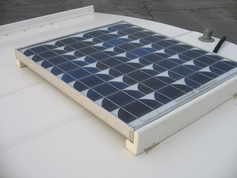

For a rigid panel, made with separate cells, the number of cells should be 36 to provide a higher open circuit voltage for charging. This panel is 32 watts. Here is photo of the panel on the Nancy H.
To prevent overcharging during storage I disconnected the panel. This panel has internal diodes so night time current drainage was not a problem.
