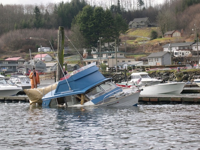

Here's why Capt Matt asked the question about the dock being floating or fixed. Photo credits to Tim and Pam on True Story....

PostPosted: Thu Feb 21, 2008 1:01 pm    Post subject: Floating Reply with quote
Ha ha...well that is some bad luck at the dock.
If you're securing to a non-floating dock you would tie the line on your cleats differently as well as other precautions.

Posts: 7932
PostPosted: Thu Feb 21, 2008 5:03 pm    Post subject: Reply with quote
Heres the thing about the above photo. It was tied to a floating dock. the problem was that they tied to the post no the dock. The dock went up and the post did not. boat got sucked under. so tie to the dock not the post. i have caught people doing it wrong around here many times. If you are at a non-floating dock you have to have longer lines in case you have a big tide. the east coast guys know more about that. I have not seen a non floating dock around here yet.

PostPosted: Thu Feb 21, 2008 5:15 pm    Post subject: Reply with quote
One of the problems with non floating docks around here is if they aren't constructed properly you run the risk of getting your gunnel or other part of the boat hung up on the dock or piling as the tide rises possibly sinking the boat. When I was a kid and we keep old boats in the water all the time we had a piling set about 40 feet from the dock. It had a block in it at the top with a line running through it with the bottom tied to a concrete block. As we approached the dock we would hook the line around a bow cleat and back up to the dock. We would then tie off to the dock get out of the boat loosen the line on the dock and let the concrete block pull the boat back away from the dock. Worked like a charm.
