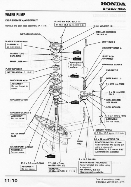

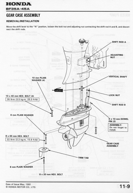

I replaced the impellers in my Honda 45's several times (1994's) when I had Captain's Choice. Not a hard job. Don't try it in the water though.
Tilt the engine all the way up, remove the 5 bolts , 4 on the sides and one at the very back under the zinc. Unscrew the shift rod, it has jam nuts on it and is on the front edge, should be able to see it. Slide the unit down and viola! it's off. The impeller is in the housing on the top. Buy the whole kit, it has gaskets, etc in it. These pix are for the 35/45's but the 40s and 50s were identical. These are in the outboards forum under pictures. There's also a complete pix history of replacement of the impeller on Almas Only Honda 90.
