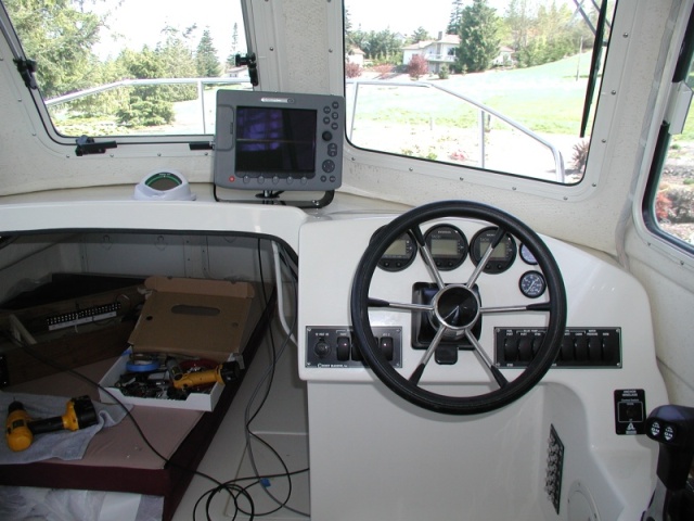

The location shown below is about the only place a Raymarine E-80 will fit on a TC-255 without infringing on your view of the water. At the speeds you will be cruising, you will want an unobstructed view. The E-80/C-80 screen is sufficient IMHO to display the 3 functions we use it for, Radar, Chart, Depth. We use a 4kw Radome. I can't comment on the 2kw model, never used one. All the best.

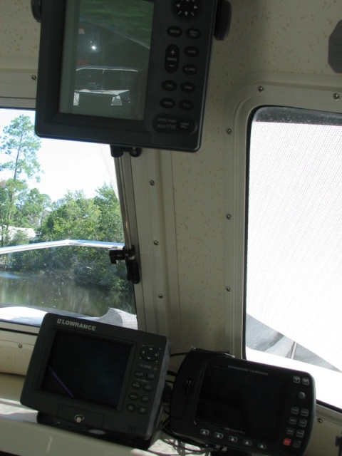

Combining thoughts from Bob and Roger (Thataway and Dreamer) is what I did on my refit. I added a 2nd E-80 to my first, which was mounted on the overhead. Big mistake, major neck cricks. After consultation with Les, both E-80s are mounted where Roger has his (on opposite sides of the center window) and as per Bob's suggestion both are on RAM mounts. We will see how well it works when I get my boat back this spring from Les, hopefully in time for Calathmet (hint, hint, hint).
