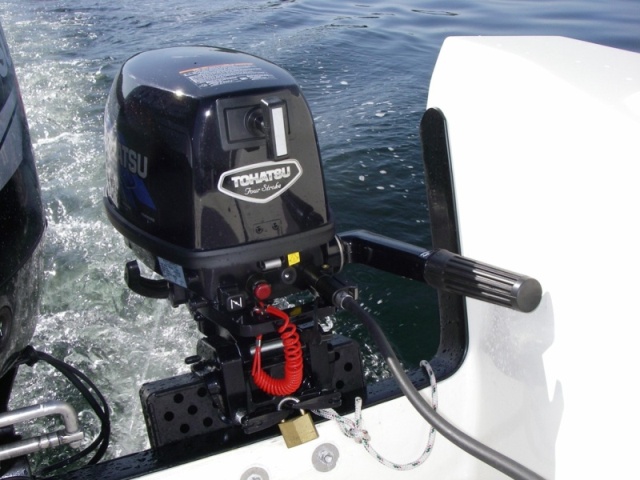

This is what I mounted my kicker on. Gets the motor up and out of the water when tilted.
I bought the motor and bracket from Les at EQ. Robbi

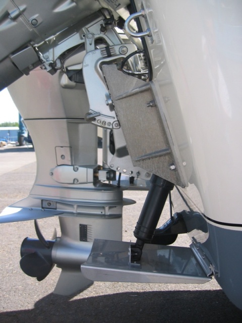

Just a thought here. I don't know if you have trim tabs or plan on getting them but the location of the kicker might be challenging. I know on my 22 that space is limited. I have a kicker bracket called a "mini jacker". It's sationary but gets the motor back out of the way of the trim tabs.
