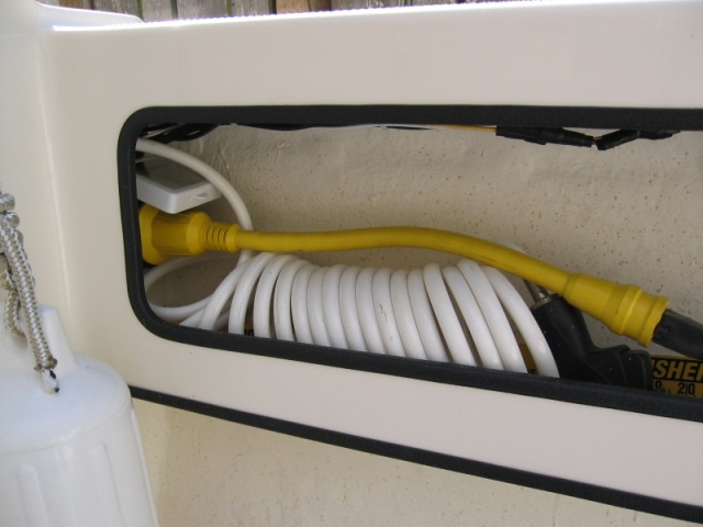

PostPosted: Thu Dec 06, 2007 7:37 pm    Post subject: Reply with quote
Here's some info on the "Jenny B" installation.
Mary & Don Anderson
Brat #483

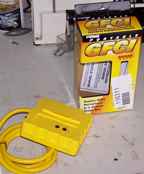

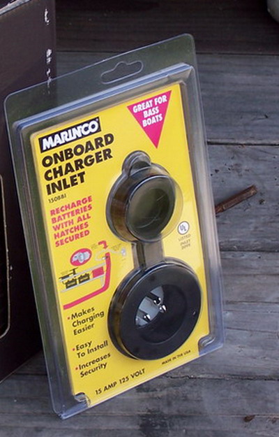

I found this CGFI box. It was the only one I could find that included a 15amp breaker.
You can find it here: http://www.hechinger.com/web/catalog/product_detail.aspx?pid=93844&cm_ven=Nextag&cm_cat=Power%20Tools&cm_pla=Prime%20Wire%20&%20Cable&cm_ite=Prime%20Wire%20&%20Cable-Accessories-93844&cid=3D0812FE46F93536A8D996F6F2CA3D26
I cut the plug off and wired directly to the marinco power inlet. I have the prosport 12amp onboard charger plugged into the CGFI.
When the boats home I use one of these pigtail adapters so I can plug an extension chord into the power inlet and charge the batteries.
http://www.marinco.com/scpt/ProdPage.php?loadItem=104A_Marinco%20Shore%20Power#
So far I have only used the "shore power" to plug in at home and keep the batteries charged so having everything on the starboard side has not been a problem. All these adapters are expensive though.
