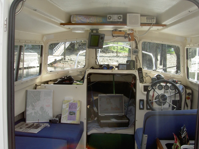

We use our laptop as a chartplotter in facts its the reason we found the C-Brat site. Prior to purchasing the laptop for the C-Dory we had zero computer experience. The previous owner of our boat used the lap top with the nobeltec software and highly recommended it to us. We still have the Lowrance 100 marine gps connected to the laptop and have our Garmin 276C connected to auto pilot. For back up either unit can be connected to laptop or auto pilot. Only use the laptop when making extended cruise and the Garmin 276C the rest of the time. Had problems with both nobeltec software and Garmin 276C on this past summer cruise. Fortunately not both at the same time.
Wished all the gps units were as trouble free as the little Lowrance 100 marine.
On a 22 the major problem we have found using a laptop as a chartplotter is where to put it so it can be easily seen and used in tight conditions and still be out of the way. Maybe some of the new smaller laptops could be installed in such a way as to not make this a problem. The Nobletec Navigational Software is probably the best to be had (don't know enough about whats available to say for sure) but if we didn't have the money already tied into what we have, I would now go with one of main brand chartplotter combinations, that are mounted out of the way and where they can be better seen.

PostPosted: Sun Nov 11, 2007 2:19 pm    Post subject: Reply with quote
This photo shows how we ended up mounting the laptop as a chartplotter on our last cruise. It was still somewhat in the way and there were times I wished I didn't have to look down at all to view it.

Ours is sitting a on a ram-mount base, but couldn't get the rest of the ram-mount to work where needed as well as those three bungee's. Unbelievable how they held the computer through some awfully rough water and it was very easy to put up or move out of the way. Also didn't want it up and where water could get to it through the center window. Sure didn't want to lose another computer like we did in Fords Terror rapids 2004.
I think but may be wrong that one of the other C-Brats was able to mount the computer with the ram-mounts on a 22. Just didn't work for me.
