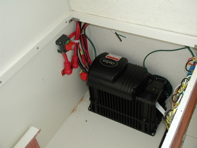

Some may call this overkill, but it works nicely for us. 2 AGM 275 amp hour 8-Ds and a 2000 watt Outback inverter. the inverter has a 80 amp battery charger and quickly charges the batteries with a Honda 2000w generator. The inverter will run the coffe maker, hair dryer, toaster oven, computer or TV. 3.5 MMUs total.
