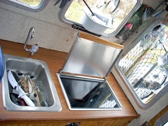

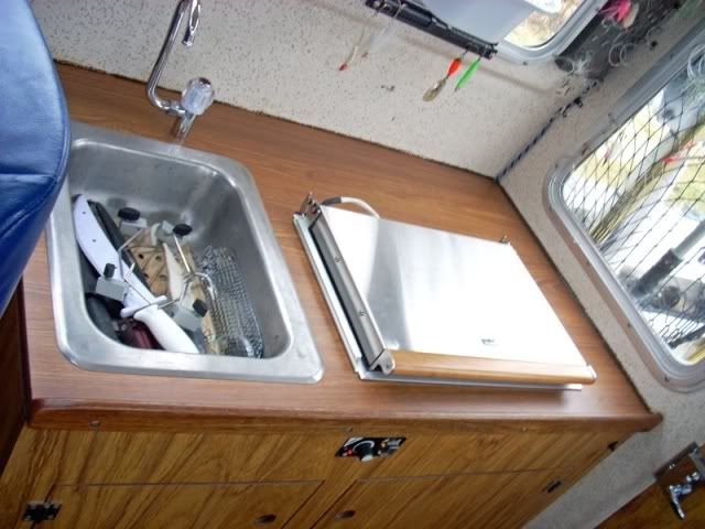

PostPosted: Sat Oct 27, 2007 8:52 pm    Post subject: Re: Just orderd a Wallas 85DU/270 Reply with quote
Finally Got er dun! Mr. Green Beer

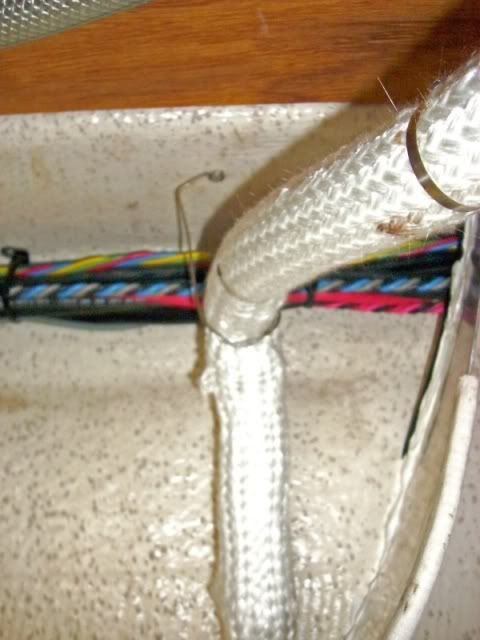

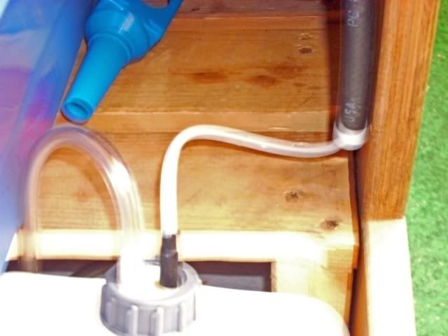

Used Wilsonart Teak Laminate, scabbed in a piece of oak to for fill (Origo stove was 3" wider), belt sanded the origional top laminate w/40 grit, put new laminate on, routed openings and reassembled! Mr. Green Beer Added a couple Stand-offs 3/32 316L tig rod to keep exh tube away from every thing. Went with the fiberglass tube insulation just out of Paranoia!! Used Stainless tie wraps to secure the insulation to the
exhaust. Used 5/16 fuel hose for conduit to run the line to the tank, Works GREAT. : Mr. Green Mr. Green Gift Xmas LOL

Adeline
Posts: 985
City/Region: Vancouver
Vessel Name: Adeline
Photos: Adeline
PostPosted: Sat Oct 27, 2007 10:44 pm    Post subject: Reply with quote
It looks awesome! Spendy, I know, but worth every cent. Since I got mine I've never, ever needed a coat or sweater even when it was below freezing outside. You're gonna love it !
Posts: 3599
PostPosted: Sat Oct 27, 2007 11:16 pm    Post subject: Reply with quote
The installation looks great. We've had good luck with our Wallas, though we rarely have needed the heat. It should be great in Alaska. No love/hate, just happy.
Looks like you got the heat blower lid, which is what sold the stove to Judy. Especially after our summer in Alaska. However, our stove has an air intake just below the countertop in the front. Do you have an air intake to supply cold air to the heater? Or do you plan to crack a cabinet drawer? Or am I messed up (again.)
