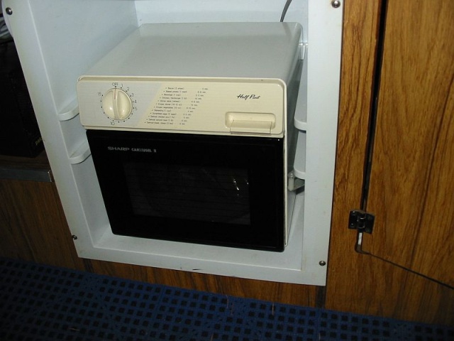

We bought the Honda 1000 (actually ~750 watts,) and it works great with a 40 amp battery charger AND the refridg. Haven't found a microwave that it will drive
Here is a microwave oven that I GUARANTEE will work fine with either the Honda 1000 or Yamaha 1000. I've owned this exact model for nearly 20 years and I took it with me when I shopped for my generator. They both powered it w/o a problem. Best of all, it fits perfectly inside the worthless icebox(door removed).
Pete

That's a neat little microwave.... it would not take much to remove that worthless ice box (first thing to go on my boat) and build it in to the boat...you might also put a shelf above or below it... I built 3 nice drawers in the place where mine went.....best thing was I built the drawers as deep as I could so I take advantage of all the space between the front and the hull...

I just replaced my old (20 years) microwave which was on the Tom Cat--with a 600 watt one, which looks identical (WalMart for $33)--it uses max of 934 watts on 120 volts. I haven't tried it on my Honda 1000 (which happens to be in Calif)--but it will run fine on a 1000 watt inverter.
The lower the power output of the microwave, the longer it will take to heat the material--the half pint is 400 watts, most of the "automatic" microwaves are at least 700 watts OUTPUT. The input on 120 volts is often 15% higher than the "output")
