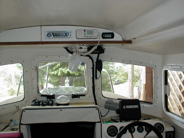

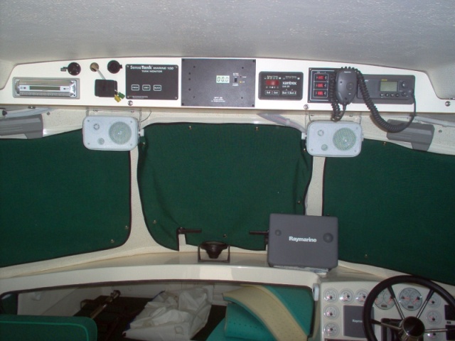

This is what I did on the 25.
This is what I did on the 22.

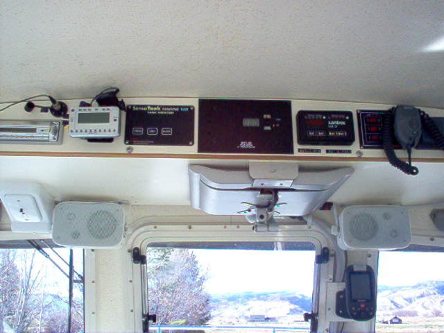

PostPosted: Sat Oct 13, 2007 8:55 am    Post subject: Reply with quote
Discovery"s overhead console.
Another look after the swing down TV monitor was mounted.

On my 22 I just made a template out of cardboard and kept trimming until it was a perfect fit. SS screws with finish washers attached from the bottom of the existing shelf up into the bottom of the face plate. This also makes it very easy to remove in the event you need to get in there in the future. The face on the 22 was only about 3 1/2 inches high to the roof as I remember, so four 1 3/4 screws held it in very securely.
As for condensation, I have never experienced it anywhere other than in the cuddy cabin and only then when I haven't left a window cracked so the exhaled moist air can escape. If you have 3-4 people in there it could be a problem.
