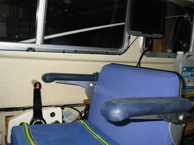

No, this has nothing to do with eating on a cruise ship. I am considering a better helm seat for our CD-25, and wonder if any others have come up with a good solution. This one that Captd has in his tug looks good...
Not sure if there is enough clearance for rotating the seat with the throttle lever. I really like the idea of arm rests, again if they would not interfere with throttle use. Has anyone out there re-seated their 25? I know we discussed this a while back, but I don't recall a particular seat/solution.

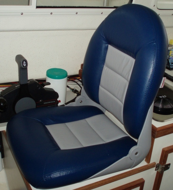

Several problems.... I changed out my seat too....to one with a good back bolster... and used one of those mounts with the rubber bushings to soften the spring action of the seat.... and it helps lots..... but after all that...it moved the seat up about 1 1/2 " and forward some...so the wheel was now to low and hit my knees...
To complicate matters I installed a Autohelm autopilot...shortened the distance between the wheel and my knees
I found that there are several different mounts for our steering units....the one our boats came with is something like a 90 degree bracket...and so the wheel is parrel with the bulkhead..... what I did was order a bracket for a 20 degree mounting..... what that did was move the wheel higher and to a angle that made steering much easier...plus gave me about 1 1/2" of knee clearance....worked fine..... to make a bezel I used a motorwell boot...it fits between the wheel and the bulkhead and looks factory.

Jim,
I have that exact same seat on my little 13' fly fishing boat. I took the arm rests off as they get in the way when working with fly lines. Wink
It is a very comfortable seat though.

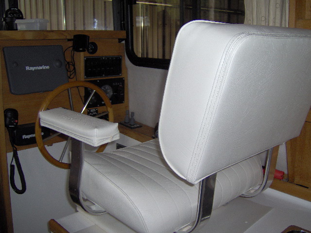

Maybe CatyMae will chime in. The replaced the helm on their 22. THe following picture is from their photo album.

The one I put in has a back bolster which really helps...I ordered from West Marine but have seen it at Boaters World...........but the thing that really helps is the back is the Garelick Active Seat Suspension Unit...($115) from West Marine.... it takes up much of the shock and jolt....it does raise the seat about an inch and a half but well worth it....that makes seeing over the bow easier....I am only 5' 10"
