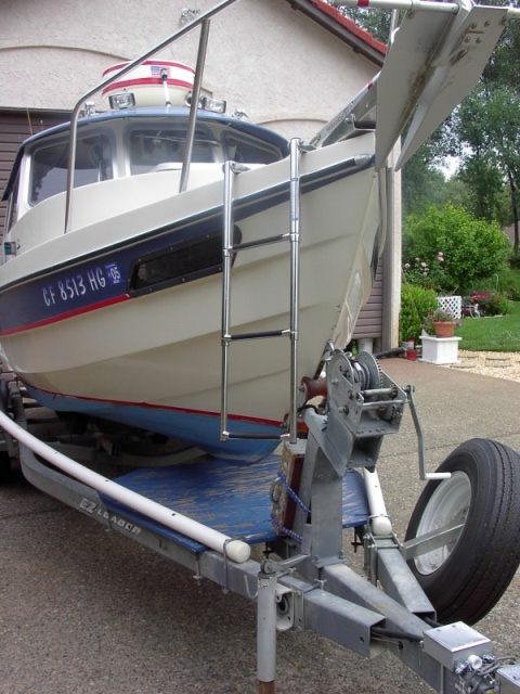

"sea wolf " liked idea for your gen. from your pics. It does not sound like you think I should use propane in the cabin though for heat.Sad Where did you buy your beach ladder, I NEED ONE! looks great.

The ladder on the front of my boat is just a standard under platform telescoping one for swim platforms from Windline with 3 steps. Makes it possible for old guys like me to get off and back on the boat on a beach or trailer.
Windline UP-3X Ladder
