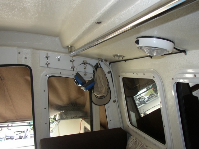

How are these installed...
From PS_Rick in the interior tech. library photos.
Mike

Hey Mike...I can speak to that picture since I recognize it being on our boat. The original owner put them on. It is starboard with I am guessing 4200 or 5200.
One of the three eventually came loose so you may want to check with the gang which is the best adhesive.
