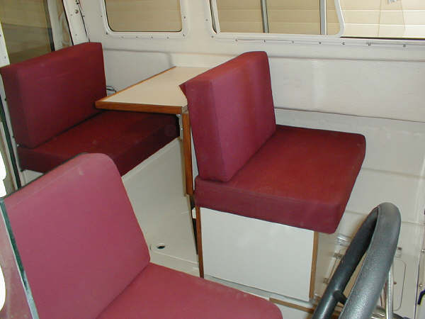

On an older boat that does not have the new option, how hard it is to convert to a forward-facing passenger seat on the port side? Are there any pix or instructions on this project?

Better than that. Check out the "Cabin, Interior" forum under the Library. The pictures start with this one and there are a bunch of them. I'm sure the discussion just above the pictures talk about it too.

The change from a fixed aft facing seat to a movable forward and aft facing seat is a managable project for anyone with moderate do-it-yrselfer skills. There are some photos in my album. Detailing the process via a posting would be tedious but I would be happy to discuss the matter.

Yup - did it last winter. Photos in my album. Purchased the hardware from www.rockler.com.
