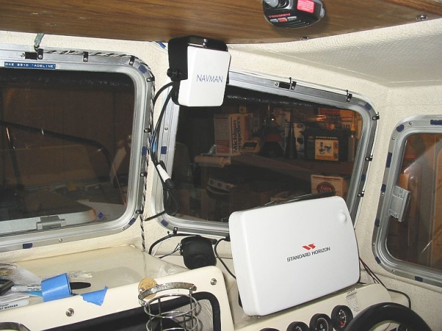

PostPosted: Thu Sep 13, 2007 9:50 pm    Post subject: Reply with quote
willingness to cut a hole in your dashboard
Not unless you want to !
