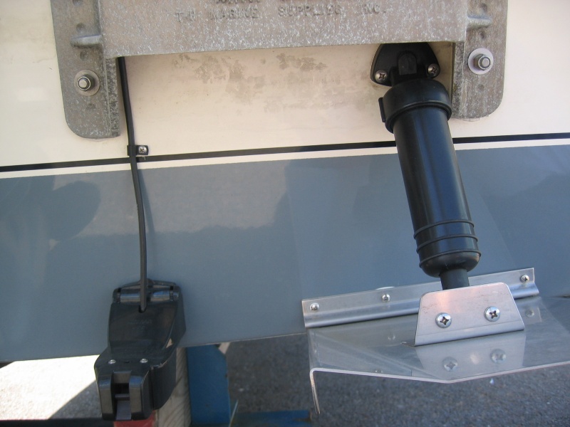

Well, I use the standard (P65) transom mounted transducer since I don't really want to install a thru hull in the C-22. It works quite well although I would prefer a wider angle in the 200khz crystal. There's a photo of the Jenny B's stern that shows where it's mounted; just to the left of the starboard trim tab.

PostPosted: Mon Sep 03, 2007 12:12 am    Post subject: Reply with quote
I also use the p65 transducer and feel that it's a decent unit. The only problem I have is picking up bottom at about the 700 foot depth and beyond. don't really know what fix there is for that though.

PostPosted: Mon Sep 03, 2007 10:47 pm    Post subject: Reply with quote
C-Dawg wrote:
Thanks.
I saw in an archived thread a discussion of mounting the transom transducer when the vessel's got trim tabs. What I took away was mounting just inboard of the trim tab and about 1/4" below bottom. Is that right?
This is where the dealer installed mine. Seems to work.

PostPosted: Tue Sep 04, 2007 5:24 pm    Post subject: Reply with quote
Thanks, that's a great photo explaining a lot.

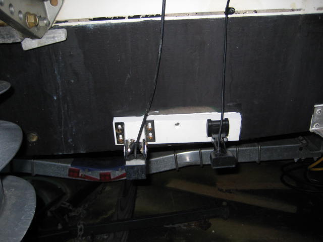

I would advise against drilling thru the transom at this level. We have found that the best way to put a transom transducer on is to secure a block of King Starboard on the transom, and then use self tapping screws into the King Starboard. This way you can move the transducer and have no risk of making a piece of swiss cheese of the transom and having water intrustion. The King Starboard is secured by first drilling an over sized hole in the transom, and filling this with an epoxy compound--Marine Tex works well. Then a small pilot hole is drilled in the transom for screws to hold the King Starboard in place--the side of the Starboard which will be next to the hull should be scored so it will allow some adhereance of 5200 (which does not adhere well to plastics). I find that making angled cuts with a Dremmel cutting disc, and shallow holes drilled at an angle work fine and then you get good adherence.
I'll take a photo later this afternoon and post it how we have the Starboard on the CD 25 and TC 255. Often one finds that he has to re-position the transducer or put in a new transducer which screw pattern does not match the old one. With the starboard one can do this with no fear of damage to the transom. The CD 25 had rot around a transducer which was installed as the one in the photo above, even with some sealant.

PostPosted: Tue Sep 04, 2007 9:41 pm    Post subject: Reply with quote
We have two transducers mounted here. One is a dual frequency Hummingbird, the other is a single fequency 200 khz digital Uniden.
I can run both at the same time, but there is interference if they are on the same frequency. I generally use the Uniden as a back up, and just run the Hummingbird fish finder. You could put bottom paint on the Starboard if you wished. I probably would let some growth occure first, and let that be a "primer" when sanded down for the bottom paint.

Thanks for the pic. I understand the concept and it makes great sense, but I got lost here:
What's the over-sized hole for? It looks in the picture that you have one bolt holding the starboard to the transom, but you mention screws to hold it to the transom. Are the screws driven from inside the hull?
PostPosted: Wed Sep 05, 2007 2:35 pm    Post subject: Reply with quote
The oversized hole is to protect the core (plywood/Balsa) and waterproof it. The pilot hole is drilled into the filler (Marine Tex) and used to hold the starboard on. No holes are drilled from the inside.

In this perticular case the entire area, and a little more, is solid glass. The transom had about 10" x 4" thru about 3/4" plywood of rot just from improperly installed transducer in a 4 year old boat, used only two seasons! There are three # 12 screws, plus 5200 holding this piece of Starboard in place. The other two screws can be seen if you look carefully in the lower corners--the left side between the transducer bracket and the right side to the outside and under the transducer bracket.

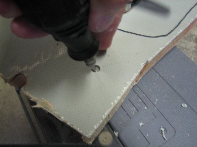

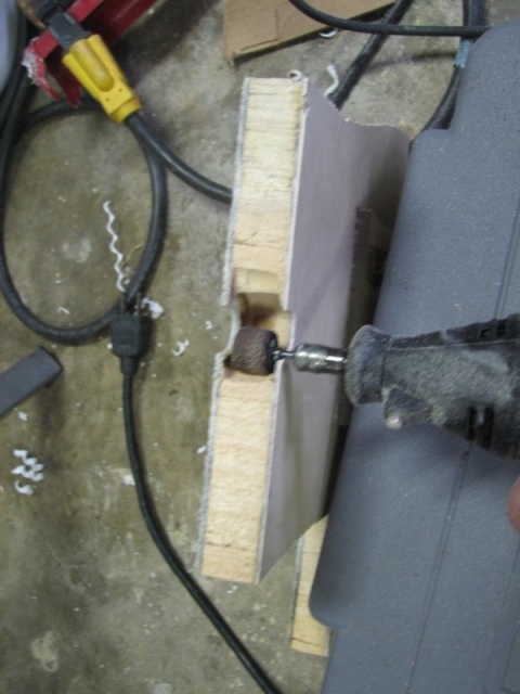

In the Tom Cat, I drilled 1/2" holes, then routed out about 1/4" of core all of the way around the three holes I drilled. This area of core was replaced with a mixture of epoxy, Cabosil and microlight fairing compound. The new screw hole was drilled in the center of this, and the block put in place with 5200.
The above is a work shop mock up of how one would drill such a hole and fill--but in this case I went from both sides--as one would do with a bolt hole or thru hull. For the screw into the transom, only drill from one side.
The second photo shows a hole drilled from one side of a deck and the under cutting--this is then filled with the compound, or Marine Tex.
