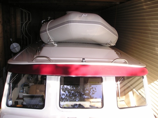

Alyssa Jean
Posts: 2376
Vessel Name: Alyssa Jean
PostPosted: Mon Aug 13, 2007 7:53 pm    Post subject: Reply with quote
You mean something like these?
They are the same as the hand holds that are on the outside of the cabin as you step in. They are a great help getting forward.
